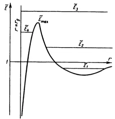

Mathematical treatment could be found at this Wikipedia page or in many GR textbooks. But we could form some intuition if we remember that the geodesic motion of a particle has an effective potential which typically (for some value of specific angular momentum) looks like this :
Image taken from book Frolov & Novikov 1998
(Image from the book V. Frolov, I. Novikov, Black Hole Physics: Basic Concepts and New Developments, 1998).
A second parameter characterizing given geodesic is specific energy $\tilde E$ and the allowed range of radial coordinate would correspond to the parts of line $\tilde E=\text{const}$ above the effective potential on the plot. A trajectory that starts at infinity and ends at infinity would correspond to the case $\tilde E_2$ in the image, it would have a turning point at some value of radial coordinate larger than the radius of unstable circular orbit ($\tilde E_\text{max}$ in the image), but unstable circular orbits lie within the interval $3/2 r_s < r_\text{uco} < 3 r_s$ (from photon sphere to ISCO).
So for a trajectory to approach within 1 m from event horizon it must be either of the type $\tilde E_3$ or $\tilde E_4$ in the image. $\tilde E_3$ corresponds to the trajectory of the particle falling into the black hole, while $\tilde E_4$ is a geodesics that starts and ends on the horizon.
