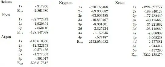

Here are some energy levels of states in noble gases, calculated using the Hartree-Fock method, from Johnson, Lectures on Atomic Physics, p. 86:
table of Hartree-Fock energy levels for noble gases
The Hartree-Fock method calculates the energies self-consistently for a particular atom, so the energies are different for the different atoms. It would be convenient to have the calculation for something like potassium, so we could see the gap between the last filled state in argon and the final electron for potassium, but he doesn't actually give those. However, you can clearly see the relevant shell gap in the calculation for krypton. There is a gap of 4.5 Ha between 3p and 3d. This is considerably larger than the gap between 3s and 3p (2.5 Ha) and between 3d and 4s (2.7 Ha).
So - what is special about p sub shells such that when they fill there is a larger gap up to the next level than when s,d, or f sub shells fill?
There is nothing special about p shells. These calculations are based on diagonalizing a big matrix. There is no particular reason to expect the spacing between subshells to follow any simple rules.
Beryllium isn’t a noble gas.
If you look at the levels for argon, you can see that the gap between 2s and 2p is less than 3 Ha, while the gap between 2p and 3s is about 8 Ha. The reason for the sizes of the gaps is ultimately just that that's what you get when you diagonalize the matrix. However, I don't find the result particularly surprising, since the unscreened potential has 2s degenerate with 2p, and a big gap between 2p and 3s.

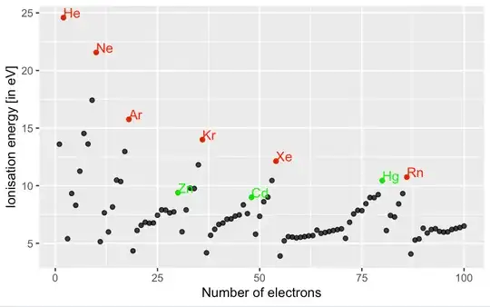

Nevertheless, I feel like we should point out that the name "nobel gas" was used before we understood the physics. Thus, the distinction becomes somewhat arbitrary, if the electron number becomes "large". In order to emphasise this argument, I took the ionisation energies (from NIST database) and plotted them as a function of the number of electrons (=#protons): ionisationEnergy By interpreting this graph see that
  • the electrons of nobel gases are "strongly" bound to their nucleus (="large" ionisation energy). Hence, nobel gases "do not like to share" one of their electrons.
  • nobel gases "do not like to accommodate" an additional electron. This can be seen by considering the atom which has one additional proton. These (alkali) atoms "like to get rid" of their additional electrons -- alkali atoms are "easy" to ionise. Thus, by adding an additional proton to a nobel gas atom does not increase the ionisation energy.
Combining these two observations, the ionisation energy is a simple measure to understand nobel gases: Neither do accommodate an additional electron, nor do they share an electron with other atoms. Thus, they are "reluctant" to react with other atoms.
In the graph I mark the nobel gases in red. We see that the ionisation energy increases steadily towards the nobel gases, it reaches it's local maximum at the nobel gas atom, and then takes an abrupt, negative step. However, this structure is also visible for the atoms with filled $d$-shell (marked in green): Here we also observe a steady increase in the ionisation energy, a local maximum followed by an abrupt, negative step. Thus, the distinction between nobel gases and atoms with filled $d$ shells is not significant. Furthermore, with increasing electron number both (a) the ionisation energy and (b) the step size in energy become approx. equal. Hence, calling radon a nobel gas and mercury a transition metal is a matter of convenience (consistency with the historical system/nomenclature) and not a statement of "stability" (in my opinion).
