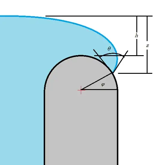

So now the question is what alpha to use. I propose that the water will continue expanding around the curved lip of a glass maintaining its contact angle until the point at which going farther along the lip would lower the top of the surface according to the above equation as at that point the surface would be unstable. This depends on the curve of the lip of the glass $r_l$.
Diagram of water about to overflow
If the water edge on the lip of the glass is at polar coordinate $\phi$ and the liquid has a contact angle $\theta$, then $\alpha=\phi-\theta$, and my total height $h$ will be given as $$ h=\sqrt{\frac{2\,\gamma}{\rho\,g}(1-sin(\phi-\theta))}+r_l\,(sin\,\phi-1) $$
Unfortunately this does not have a closed form maximum over theta, but we can see that for small values of $r$ the maximum will be when $\phi\lt 0$. This is not physical as the liquid would start creeping down the side of the glass and become unstable first. We can solve for the value of r at which this occurs $$r_l=cos\,\theta\sqrt{\frac{\gamma}{2\,\rho\,g\,(1+sin\,\theta)}}$$ For any lip radius under this value the maximum liquid height would be $$ h=\sqrt{\frac{2\,\gamma}{\rho\,g}(1+sin\,\theta)}-r_l $$

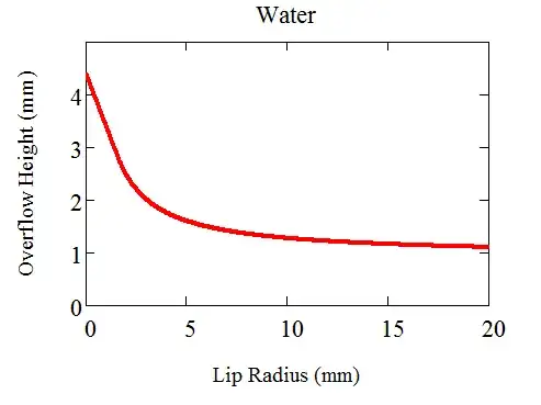

For water this radius calculates out to about $1mm$ and for a glass with a very small radius the height calculates out to about $4mm$ a bit higher than I've managed, but not unreasonable for a theoretical upper bound.

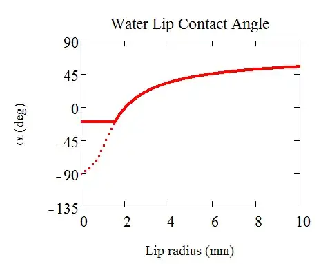

For glasses with a larger radius the maximum height can be solved numerically. Here's a plot. Water Overflow Plot
And the corresponding "lip contact angles"
Lip contact angle vs. lip radius

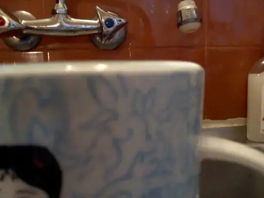

I experimented with my tea cup, a nice long cylinder.
The water was slightly climbing the walls making a concave surface. When it reached the edge I dripped water until the outer edge became convex and the water surface is almost a dome, though I only see the curvature at the rim where the water does not flow, displaying surface tension (both to the water and the ceramic).
cup overfilled
I am shining a flashlite and the reflections seen are on the water. The curvature at the right is on water. It retained its shape after it overflowed ( I was dripping the water). Radius of cup 3.5cm, height of water about 1mm .
