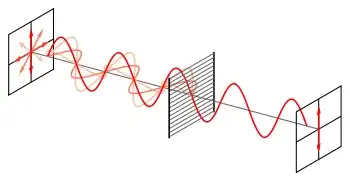

Take the wire grid polariser as a more simple example
It consists of a regular array of fine parallel metallic wires, placed in a plane perpendicular to the incident beam. Electromagnetic waves which have a component of their electric fields aligned parallel to the wires induce the movement of electrons along the length of the wires. Since the electrons are free to move in this direction, the polarizer behaves in a similar manner to the surface of a metal when reflecting light; and the wave is reflected backwards along the incident beam (minus a small amount of energy lost to joule heating of the wire).
wire grid polariser
A wire-grid polarizer converts an unpolarized beam into one with a single linear polarization. Coloured arrows depict the electric field vector. The diagonally-polarized waves also contribute to the transmitted polarization. Their vertical components are transmitted, while the horizontal components are absorbed and reflected.
The magnetic component in this setup cannot interact to affect the absorption of the light the way the electric can with the free electrons in the metal of the wire.
