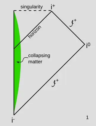

Yes, that's really the case. Those regions don't exist for a black hole that forms by gravitational collapse. For a black hole that forms by gravitational collapse, the Penrose diagram looks like this:
penrose diagram of an astrophysical black hole

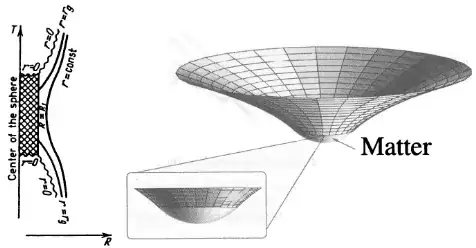

Expanding and collapsing dust sphere
To the left, there is a spacetime diagram in Lemaître-like coordinates (so that $R=\mathrm{const}$ corresponds to radial timelike geodesic). Note, that along the line $R=\mathrm{const}$ the radial variable $r$ starts from zero at both top and bottom singularities and achieves maximal value at the turning point $T=0$ (which is also $t=0$). Doubly dashed region is a FLRW patch, Schwarzschild region is to the right. Big Bang singularity of the FLRW metric joins with the past singularity of a white hole, while Big Crunch joins with the future singularity of a black hole. The right part of the image is an embedding diagram for the spatial section of a spacetime at the turning moment $t=0$, when expansion of a dust sphere changes to contraction (with one of the angular coordinates suppressed). The dust matter part of the geometry is precisely part of a $S_3$ sphere while outside region is an embedding of spatial Schwarzschild geometry.
Radial Schwarzchild geodesics are characterized by the value of specific energy $\epsilon=E/mc^2$, with $\epsilon<1$ since we are interested only in bound motion. By varying this parameter we would obtain a family of similar solutions. Values $\epsilon=1-\text{small number}$ correspond to dust cloud expanding to a large radius before collapsing, smaller positive value of $\epsilon$ corresponds to smaller radius of maximal dust cloud expansion.

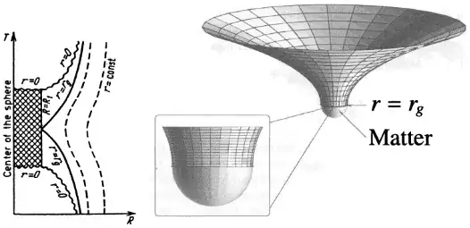

When $\epsilon=0$, the maximal expansion radius is equal to Schwarzschild radius of the black hole:
E&C dust sphere with the maximum expansion radius = rg
We have precisely half of FLRW solution glued together with precisely half of maximally extended Schwarzschild manifold, (full region I, right halves of regions II and IV). Dust from Big Bang singularity only touches the horizon without emerging from it, and then falls back. The spatial embedding diagram for $t=0$ has half of a sphere glued together with spatial Schwarzshild along the horizon.

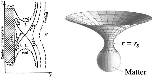

But we also know that inside the horizon there are geodesics with negative specific energies. Such solutions would have following diagram:
Dust universe cloud is inside the horizon
We see that there appears a piece of the parallel world region III of the Schwarzschild manifold. And this region together with the FLRW patch (which is now comprises more than a half of a manifold) could be interpreted as a separate world, causally separated from the world of region I. This world is a universe of closed cosmology in which (once the universe expanded large enough) a void appears without dust matter but with a black hole of equivalent mass. The embedding diagram of spatial section $t=0$ exhibits a characteristic throat feature, the Einstein–Rosen bridge.

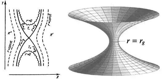

As the parameter $\epsilon$ becomes closer and closer to $-1$ the time interval between Big Bang and Big Crunch of the parallel world become longer and longer, while the size of dustless void becomes larger and larger. So taking the limit and replacing closed cosmology with asymptotically flat spacetime we arrive at the maximally extended Schwarzschild manifold:

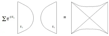

For example, in the paper by van Raamsdonk, arXiv:1005.3035, maximally extended Schwarzshild-AdS spacetime appears as a gravity dual to a state of pair of entangled CFT .
image from van Raamsdonk's paper
