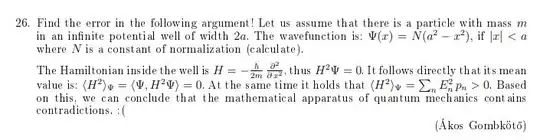

So the main idea of the problem was to find the error in the argument, which I think I have a good grasp of. Basically, the Hamiltonian of the wavefunction is a constant non-zero value inside the box and zero outside. So $H^2\not=0$ at the edges, and hence the first statement saying that $H^2=0$, is definitely wrong. My question, is there a way to actually calculate the expectation value of $H^2$ because whenever I try to do that, I seem to end up with the derivative of a delta function and I have no idea how to figure that out.
Courtesy: Rudolf Ortvay Problems in Physics.
The answer is that the considered function, though it belongs to the (essential)selfadjointness domain of $H$, $$D(H):= \{f: [-a,a] \to \mathbb C \:|\: f\in C^2([-a,a])\:, f(\pm a)=0\}$$ it does not belong to any (essential)selfadjoitness domain of $H^2$. So it does not make sense to compute its expectation value through that formula. To check my assertion try, integrating by parts, to prove that $$\langle \Phi, H^2 \Psi\rangle=\langle H^2\Phi, \Psi\rangle\qquad \Psi,\Phi\in D(H)\quad (false)$$ You will see that the operator is not even symmetric on that domain because you can find functions vanishing at $\pm a$ though giving rise to non-vanishing boundary terms.
The same argument proves that $$0=\langle \Psi, H^2 \Psi\rangle\neq \langle H\Psi, H\Psi\rangle>0$$ where $\Psi$ is that in OP's question.
I stress that there are however elements of $D(H)$ (a dense set actually!) which belong to an essentially selfadjointness domain of $D(H^2)$, these are in particular the finite linear combinations of eigenvectors of $H$. However $\Psi$ is not of that type.
