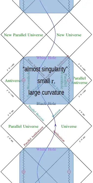

For the global structure of spacetime one should remember that while Penrose diagrams are useful tools, they do leave out a lot of information. In case of Kerr geometry, they do not give idea about how the geometry varies with varying spin parameter $a$. As $a$ approaches zero, the radial sizes of inner features of the Kerr metric: the inner horizon, ring singularity, CTC region and inner ergosphere all go to zero, while the values of curvature tensor at these features diverge. So if we ascribe to our test observer some realistic features such as a finite size and a maximal value of spacetime curvature she might endure before being destroyed, then no matter what values we choose, for a given mass of a black hole there would be a minimal value of $a$ for which there are trajectories that enter the black hole and leave the white hole in a parallel universe such that observer could survive the travel. For all smaller values of the spin parameter the observer would be destroyed by encountering a region of high curvature.
Regions of large curvature shaded
Thus the full Kerr MAE manifold in the limit $a\to 0$ becomes a countable sequence of Schwarzschild MAE manifolds disconnected from each other, as the regions inside the inner horizons become a sequence of Schwarzschild black and white hole singularities with finer features of Kerr solution becoming inaccessible to any physical observer.
