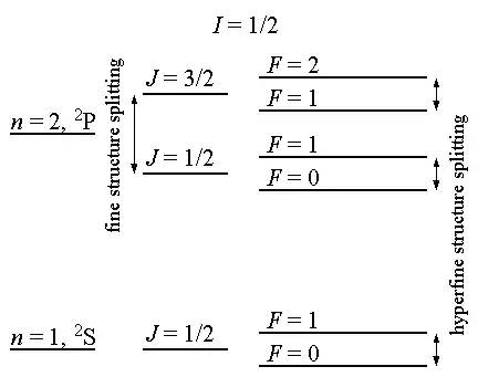

Finally, as for the term "hyperfine structure":
  • We use the term "structure" because these small energy differences between levels which are very close to each other will most often manifest themselves in optical transitions, so that if you are e.g. exciting a caesium atom from the ground state by moving the lone $6s$ electron to a $7p$ orbital, and you have a very stable laser and a clean experiment, then the line will resolve into two individual components which correspond to the two energy levels described above. (With additional complications coming e.g. from the multiple spin orientations of the $7p$ orbital, but you get the picture.) Basically, the line acquires structure, which is where the term comes from.
  • The term "hyperfine structure" is there to distinguish the mechanism from that of fine structure, which is a similar separation of orbitals into sub-levels caused by relativistic effects as well as magnetic interactions between the electron spin and the orbital angular momentum of the state.
    For almost all atoms, those interactions are stronger than the magnetic interactions with the nucleus, so that the optical transition will first split into components caused by the relativistic effects (hence "fine structure") and, if you look extremely closely and with a very stable laser, each of those fine-structure components will split into sub-lines that are even closer together (hence "hyperfine structure").

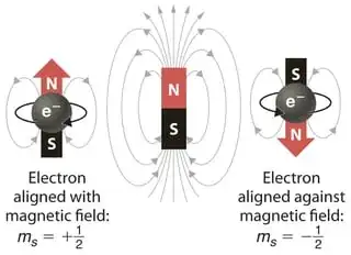

In addition to all the other very good answers here, I would like to clarify why the spin changes the energy level of an electron.
Magnetic Moment
The electron spin corresponds to a magnetic moment - in a very simplified (and inaccurate!) picture, the electron can be seen as spinning. It behaves as a spinning, charged ball, which in turn means that there is a charge density moving: that's a circulating current! This produces a magnetic field perpendicular to the plane in which the current flows.
The magnetic field of a small current loop looks like that of a small bar magnet. Imagine placing a bar magnet inside of an external, homogeneous magnetic field. If there is an angle between the direction of the magnetic moment of the magnet and the field lines of the external field, there will be a torque acting on the magnet. This torque rotates the magnet until the lines are aligned. This reduces the energy of the system.
Why? It's analogous to the case of a ball rolling down a hill. The potential energy of the ball on top of the hill is higher than at the bottom. Similarly, the magnetic moment has a higher potential energy if it is not aligned with the external field lines.
Gross Structure
The states of the electrons in an atom are defined by the quantum numbers $n, m, l, s$. The Schrödinger equation delivers an expression for the energy of an electron with quantum number $n$ in an atom with proton number $Z$: $$E_n = -\frac{Z^2}{n^2} E_R$$ where $E_R$ is the Rydberg energy (13.6 eV).
Fine Structure
This is all nice, but real atoms do not behave much like this simplified model - it does not take into account that electrons and protons are electrically charged, and that all constituents have a spin (neutrons, protons and electrons are all fermions with spin $1/2$).
A first correction is to not use the Schrödinger equation, but the Dirac equation. It treats particles with spin and also takes into account relativistic effects. Here it turns out that most levels from the gross structure split into two. This has mainly to do with the fact that their spin $\vec S$ and orbital angular momentum $\vec L$ (from the movement around the nucleus) are coupled and allow only certain energy values.
Hyperfine Structure
Finally, the electron spin also interacts with the nuclear spin. Protons and neutrons are also spin-1/2 particles. As discussed previously, the interaction between these magnetic moments favors certain arrangements of electron and nuclear spin, which results in discrete energy levels. enter image description here
