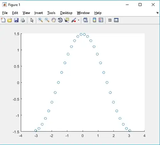

My attempt at calculating the phase using the Susskind-Glogower operator:
The Susskind-Glogower operator is not unitary, and therefore $\langle \phi \rangle$ is undefined. To remedy this, other operators related to this operator can be calculated, such as $\cos(\phi)$:
\begin{align} (N+I)^{-\frac{1}{2}} a + a^{\dagger}(N+I)^{-\frac{1}{2}} =(a^\dagger a+I)^{-\frac{1}{2}} a + a^{\dagger}(a^\dagger a+I)^{-\frac{1}{2}} \end{align}
But when I try to calculate value for a coherent state, I get results I do not expect. (Which I posted the code for at the end, if anyone is interested.) I've posted a plot for illustrating this (in which I graph the obtained output phase $\langle \phi \rangle$ as I very the input phase $\theta$ for the coherent state $\alpha = |\alpha|e^{i \theta}.$
The output corresponds to the operator for $\langle \cos(\phi) \rangle$, and it varies from $-\pi/2$ to $\pi/2$. Shouldn't this vary from $0$ to $1$ since it is the cosine of the argument? And either way, what use is it to find the cosine of the phase?

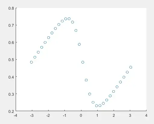

My attempt at calculating the phase using the Pegg-Barnett operator:
The Pegg-Barnett operator has been said to resolve the nonunitary issues of the Susskind-Glogower operator. The paper I'm using as a reference doesn't appear to explicitly write the operator in the Fock state basis, although they write what a Fock state is in this phase-operator basis:
$$|n\rangle = U|\phi(n)\rangle = \sum_m \exp(in(\theta + 2m\pi)/(s+1))$$
And thus I can write the phase operator as: $|\phi(n)\rangle \langle \phi(n)| = U^\dagger |n \rangle \langle n| U$ . But when I calculate the expected value of the phase $\langle \phi \rangle$ for coherent states, I get incorrect answers (that also vary as I change the value of $|\alpha|$. Here's a visual of how $\langle \phi \rangle$ varies as I change the input phase of $\alpha = |\alpha|e^{i \theta}$:
Here is the Matlab code I used if anyone is interested in going through it (Note: I just recently added a 3rd part that corrects for an error I made in the Pegg-Barnett method):

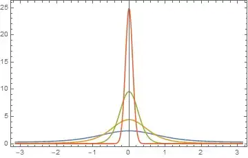

As I understand the situation, the current consensus is that the best way to measure phase is using a POVM, $$ \int \frac{\mathrm d\phi}{2\pi}|\phi⟩⟨\phi| = 1 \quad\text{where}\quad |\phi⟩ = \sum_{n=0}^\infty e^{in\phi}|n⟩, $$ and that it's not particularly worth it to go looking for an explicit operator.
Using this convention, if you want the phase distribution for a coherent state $|\alpha⟩$, you just plot $$ f(\phi) = |⟨\phi|\alpha⟩|^2 $$ which looks like this for $\alpha = r e^{i\theta}$ with $\theta=0$ and $r=0.5$, $1$, $2$ and $5$ (in blue, yellow, green and red, resp.):
Mathematica graphics
As you'd expect, the higher the mean photon number, the smaller the phase uncertainty.
I'm unable to locate good references for this formalism at the moment. I'll add them later if I do find them.

The Pegg-Barnett operator is in principle a good phase operator if the Fock-space is truncated (which is usually not a problem, to put a wavevector into the computer, you'll need a truncation anyway.)
So, what is the reason that you get this 'wavy'-pattern in your figure instead of a straight line? A first thing to keep in mind is the periodicity of the phase: so the best thing you can hope for is a sharp sawtooth function. In practice, a PB-operator (and basically any other attempt to calculate a phase) must assume an interval e.g. $[0,2\pi[$, implying a sharp cut at the edge. I see you did retrieve the periodicity. The reason your edges are smoothening is the following: A coherent state is not a phase eigenstate, so it has a finite variance of the phase. This becomes an issue when your coherent state is located close to the phase-cut: then part of the state (a tail of the distribution) actually crosses this cut! If you have for example a state $|\alpha\rangle=|0\rangle$, half of the state has a phase $\approx0$ and the other half a phase $\approx2\pi$, giving a total result of $\pi$!
As a practical approach to find a way out, you (as I briefly explained in an an answer to an old question of my own https://physics.stackexchange.com/a/380324/25292) can exploit that the PB-phase has a free parameter (the reference phase, corresponding to where you lay the phase-cut) and update this one dynamically until you get a proper result. Some MATLAB code I used (currently assumes wavefunction instead of density matrix, but the extention is straightforward as I have indicated in the code):

I had exactly the same requirement as you: the linear (sawtooth) relation between input and 'measured' phase for a coherent state, and it works perfectly. In practice, I have been applying this mainly to states with a 'banana' shaped W-function, so it should definetely work for your states. Convergence is usually reached without a problem as long as the density is not very close to zero. Of course, the state should not be spread out a full $2\pi$ for it to work (then there wouldn't be any phase anymore). You obtain the suitable operator as a result, which can be further used to calculate higher moments of the phase.
Reference: https://doi.org/10.1103/PhysRevA.100.013804 (Appendix B)
