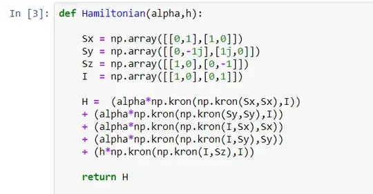

I'm currently doing a research project involving 3 particle spins and have developed a simple function for the Hamiltonian:
I understand how to code my work but the physics behind it is unfamiliar territory to me. Can someone please explain what exactly the purpose of the tensor product is and how it relates to particle spins. I also am currently learning about the Bloch Sphere in relation to qubit states which has become more clear to me now but I am just unsure about the function of tensor product when performed on 2 matrices.
If anyone could point me in the direction of an explanation to tensor product i.r.t particle spin matrices I'd apreciate it

Now, the reason you take tensor products in quantum mechanics is because you are dealing with multiple particles at the same time. In your case, your code is taking tensor products between three spin matrices, each of which represents a single particle, which tells me that you are dealing with three particles at the same time.
You might wonder why you can't just store three separate spin matrices — one for each particle. And the reason for that is one of the big ideas in quantum mechanics: entanglement. That means that the system cannot be described completely by describing each particle separately. In your case, you'll see that the Hamiltonian can't be written as the sum of the energies for the separate particles; you really have to look at all three at the same time.
