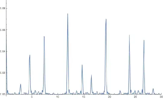

I know that quasicrystals are defined by having sharp diffraction peaks. So I can numerically (or analytically) calculate the diffraction pattern from the Fibonacci chain. In this case I calculated the Fourier transform of a Fibonacci chain with 21 segments, namely \begin{equation} L, S, L, L, S, L, S, L, L, S, L, L, S, L, S, L, L, S, L, S, L \end{equation} with $S = 1$, $L = $ golden mean and I see it has sharp peaks:
Diffraction of Fibonacci chain

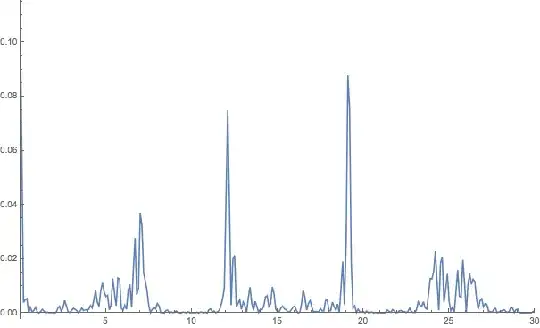

Then I compare it to that of a pseudorandom chain \begin{equation} S, L, S, S, S, S, L, S, S, S, L, L, S, L, S, L, S, L, S, S, S \end{equation} which is generated randomly.
Diffraction of random chain
Ok, one could argue these peaks are not as 'sharp' as in the QC case but this depends a lot on the definition of 'sharp' (or, rather, 'discrete'). Also, I know that my example is probably not very well-defined because on a 21-long chain the difference between random and quasiperiodic might be hard to pin down. However, it would be nice to find a more elegant argument without me having to zoom into the diffraction pattern of extremely long Fibonacci/random chains (which cost a lot of numerical effort) to show the difference.
