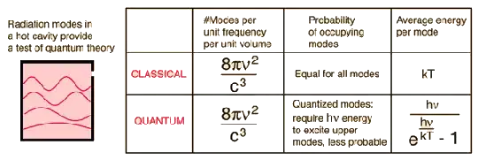

bbody
The classical mode leads to the ultraviolet catatstrophy, because all possible frequencies have equal probability of being occupied by radiation.
The quantized modes repress the higher frequencies, which is what is observed experimentaly.
bbody2
The formula used
bbody3
leads to the conclusion that each frequency comes in packets with energy = h*nu
There is a continuum of frequencies, but less occupied as the frequencies go up, in the cavity model used.
