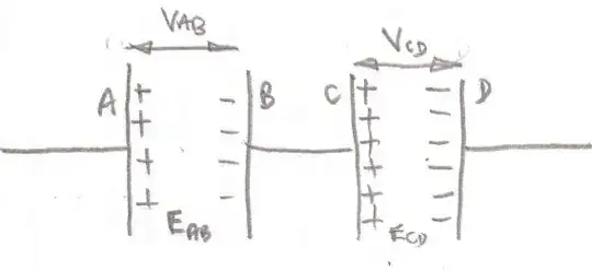

Consider first two charged capacitors which are connected in series.
The potential of plate $A$ relative to plate $B$ is $V_{\rm AB}$ and the potential of plate $C$ relative to plate $D$ is $V_{\rm CD}$ so the potential of plate $A$ relative to plate $D$ is $V_{\rm AB} + V_{\rm CD}$.
Within each capacitor there is an electric field and the work done by an external force in taking unit positive charge from plate $B$ to plate $A$ is $\int_B^A E_{\rm AB} \,d s$ and from plate $D$ to plate $C$ is $\int_D^C E_{\rm CD} \,d s$.
The total work done is $D$ to plate $\int_B^A E_{\rm AB} \,d s + \int_D^CE_{\rm CD} \,d s$.
This is the same result as the addition of potential differences.
What about the conductor between plates $C$ and $D$ as it might appear that the negative charges on plate $B$ should neutralise the positive charges on plate $C$ and due to those charges is there an electric field in the conductor between plates $B$ and $C$.
Well there is no electric field within that conductor and the charges on plates $B$ and $C$ are held in place by the charges on plates $A$ and $D$ respectively.

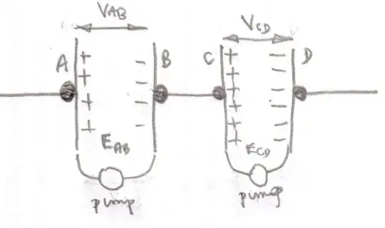

So what about ideal cells connected in series?
If effect cells have two plates which include the terminals.
These terminals/plates get charged up by an electrochemical process which can be thought of a charge pump (sorry about the water analogy).
Initially the plates terminals are uncharged and the charge pump moves charges from one terminal to the other terminal making one terminal having a net positive charge and the other terminal having a net negative charge.
The net charges on the terminals produce an electric field within the cell which opposes the pumping of charges from one terminal to the other by the charge pump (electrochemical process).
Eventually that electric field is enough to stop the migration of charges between the two terminals.
Each cell has a certain potential difference across its terminals and the addition of these potential differences is the same as for the example with capacitors.
So what is different about the cells as compared with the capacitors.
The key difference is that as soon as the terminals of a cell are connected together with a conductor charges will flow from one terminal to the other in the external circuit.
The reduction in charge on the terminals would result in a reduction in the electric field between the terminals but that electric field is no longer sufficiently strong to stop the charge pump pumping charges causing a migration of charges between the two plates within the cell.
The charge pump moves charges within the cell to compensate for those charges which flowed from one terminal to the other terminal via the external conducting circuit.
In effect the charge pump maintains the potential difference across the terminals whereas with a capacitor there is no mechanism for maintaining the amount of charge stored on the plates.
The removal of charges from terminals $D$ and $A$ would result in a migration of charges between terminals $C$ and $B$ ie an electric current flows between the two cells.
