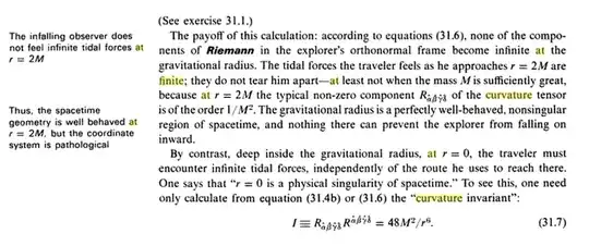

Courtesy of Google books, here's the relevant section from "Gravitation":
Misner, Charles W., et al. Gravitation. Princeton University Press, 2017.
The payoff of this calculation: according to equations (31.6), none of the components of Riemann in the explorer's orthonormal frame become infinite at the gravitational radius. The tidad forces the traveler feels as he approaches $r=2M$ are finite; they do not tear him apart-at least not when the mass $M$ is sufficiently great because at $r=2M$, the typical non-zero component $R_{\dot{\alpha}\dot{\beta}\dot{\gamma}\dot{\delta}}$ of the curvature tensor is of the order $1/M^2$. The gravitational radius is a perfectly well-behaved, nonsingular region of spacetime, and nothing there can prevent the explorer from falling inward.
By contrast, deep inside the gravitational radius, at $r=0$, the traveler must encounter infinite tidal forces, independently of the route he uses to reach there. One says that"$r=0$ is a physical singularity of spacetime." To see this, one need only calculate from equation (31.4b) or (31.6) the "curvature invatiant":$$I\equiv R_{\dot{\alpha}\dot{\beta}\dot{\gamma}\dot{\delta}}R^{\dot{\alpha}\dot{\beta}\dot{\gamma}\dot{\delta}}=48M^2/r^6$$
