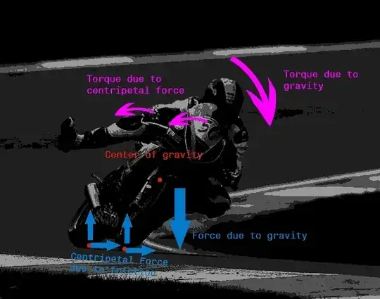

It is actually not the tilting that causes more turning. You could in theory turn just as much while being straight up by just turning your steering wheel.
But if you do that straight up, you fall. The torque produced by the friction from the turned wheel is unbalanced and will flip you over. When you turn on a bike, your body automatically leans in and tilts slightly - not because that tilting does the turning, but because it keeps your balance.
By tilting your bike, you move your centre-of-mass sideways, so that gravity causes a larger and larger torque in you. When this gravity-torque counteracts the friction torque exactly, your turn is stable and you won't fall while turning.
So, the tilt doesn't cause sharper turning, but it allows for sharper turning without you falling over.

Notice that when the biker tilts more, the torque due to gravity increases(taking pivot to be any point other than point of contact or center of mass as then centrifugal forces would be needed to balance torques in an accelerated frame). Also notice that it is friction that is the counter/opposing torque to the torque by gravity. Hence as the biker tilts more, the frictional force must increase. And as frictional force is the centripetal force: $$F=\frac{mv^2}{r}$$ $$r=\frac{mv^2}{F}$$ So as $F$ increases, the radius of the turn must decrease. We can derive further with the reaction force having components $Rsin(\theta)$ equal to gravity so $$Rsin(\theta)=mg$$while the frictional component is $$Rcos(\theta)= \frac{mv^2}{r}$$. From these we can derive directly the relationship between the angle of tilt and the radius of the turn for a constant speed. It follows that $$\frac{Rsin(\theta)}{Rcos(\theta)}= tan(\theta)= \frac{gr}{v^2}$$ Thus it is again clear to see that the radius,$r$ is proportional to $\theta$ which is angle with the horizontal so the lower the angle, the more the tilt and hence lower the radius.
Note: Of-course the causality does not go on that bending more means shorter turns but rather, for stability as has been assumed in this derivation, bending more leads to shorter turns as quoted in previous answers or smaller $r$.

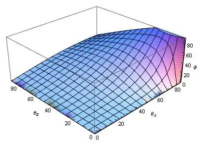

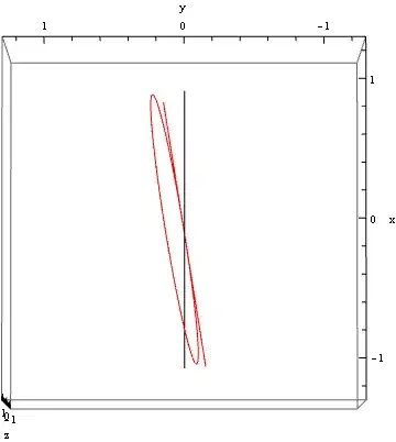

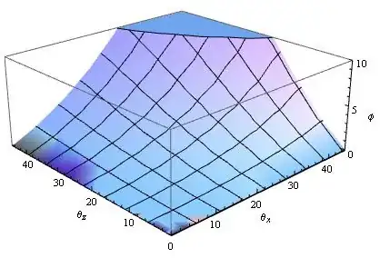

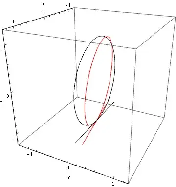

There is an effect is due to geometry. Turn the front wheel of a bike to the left by thirty degrees, say. Now lean the bike into the turn. For simplicity, suppose that you could lean the bike completely on its side while the tires maintain contact with the ground. Having done so you will find that the turning radius is now roughly the one that would be achieved by turning the front wheel to ninety degrees while keeping the bike upright. (If the front wheel can't be turned to ninety degrees, this turning radius is not even achievable without tipping the bike.) This shows that tipping the bike affects its turning radius.
Figure 1. Here we assume a rake of 25 degrees. $\theta_x$ is the tilting angle and $\theta_z$ the turning angle with respect to the handlebars. $\phi = \theta'-\theta$, where $\theta$ and $\theta'$ are the angles the tire makes with respect to the forward direction before and after tilting the bike. (Note that due to the rake of the bike, $\theta_z\ne\theta$.)
Figure 2. One can see that for small turning angle that tilting the bike has little effect, agreeing with our intuition, but that for any turning angle the effect grows with tilting angle and can become a large effect.

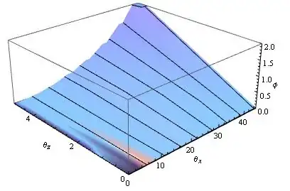

Figure 3. For a turning angle of two degrees the effect of tilting 45 degrees is appreciable.
Figure 4. Here we assume a rake of 25 degrees and let the turning angle be ten degrees. The tilting angle varies from zero to 45 degrees.
Figure 5. A top view of the situation depicted in Figure 4.

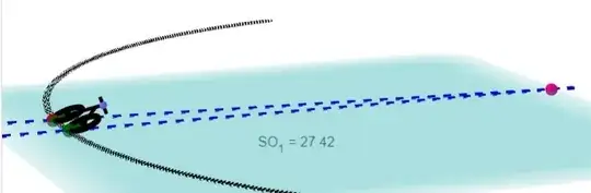

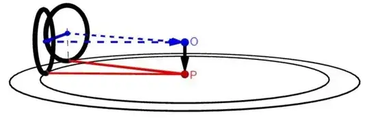

I will start with the simplified version of why a bike follows a tighter turn when leaned.
In the diagram above using a (very) simplified bike model consisting of two connected wheels, the un-leaned bike follows a clockwise circular path around a point determined by the projection on to the ground of the intersection of lines drawn through the axles of the wheels, that are perpendicular to the circumference of the wheels.

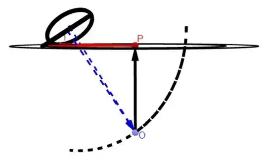

When the bike is leaned over, the intersection is rotated to a point beneath the ground, but since the bike is constrained to remaining on the surface, it follows a circular path around the upward projection of the intersection and due to the geometry, the centre of the turn is now much shorter. This is the main reason a bike turns tighter when leaned over.

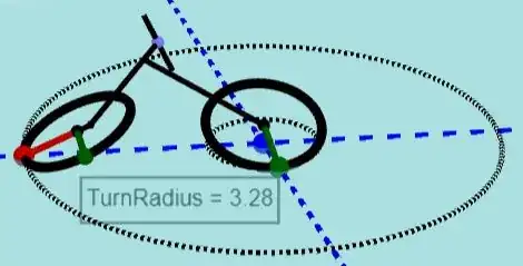

What follows is a more detailed analysis of a more realistic bike model.
There is an additional effect, due to the contact point of the front wheel moving forward when the bike is leaned over. This can easily be demonstrated by laying a bike on its side and turning the handle bar until the frame of the bike is lifted off the ground. The contact point of the front wheel is now in front of the axle instead of directly below it.
The diagram shows how the contact point (red segment) of the front tyre is almost at 90 degrees to where the contact point is when the bike is upright (green segment). In the diagram the handle bar is only turned by 30 degrees but the turning radius is greatly reduced, equivalent to having the handlebars turned at 90 degrees when the bike is vertical. In order for a vertical bike to complete a turn this tight, the rear wheel has to be stationary which is not practical and since the front wheel is at 90 degrees to the rear wheel, the rear wheel tries to push the front wheel sideways causing loss of grip in slippery conditions. When the bike is leaned over, note that the rear wheel completes its own small circular path, so it it is not stationary and the front wheel is not exactly at 90 degrees relative to the contact patch of the rear wheel, so there is less chance of slipping or stalling.
In the above image it can be seen that the bike executes a respectably tight turn while greatly leaned over with just 2 degrees of turn at the handlebar. To a casual observer it can look like the wheels are in a straight line.

The GeoGebra 3D construction that I made to create these images is here. It is not exactly 'production ready', but it is there for those who find interactive simulations more intuitive and enlightening than static images and words. For the really keen, there are additional sliders in the algebra menu to alter fork angle (a), frame length (b), wheel radius (r), fork length (w), rake angle (u) and rake displacement (v).
