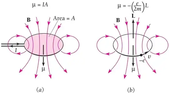

The magnetic moment of the orbital electron in a hydrogen atom depends on its angular momentum L. Hence both the magnitude of L and its orientation with respect to the field determine the extent of the magnetic contribution to the total energy of the atom when it is in a magnetic field. The magnetic moment of a current loop has the magnitude
$$\mu = IA$$
where $I$ is the current and $A$ the area it encloses. An electron that makes $\mathcal f$ rev/s in a circular orbit of radius $r$ is equivalent to a current of $- e \mathcal f$ (since the electronic charge is $-e$), and its magnetic moment is therefore
$$\mu = -e \mathcal f \pi r^2$$
Because the linear speed $v$ of the electron is $2 \pi \mathcal f r$ its angular momentum is
$$L = mvr = 2 \pi m \mathcal f r^2$$
Comparing the formulas for magnetic moment $\mu$ and angular momentum $L$ shows that
$$\text{Electron magnetic moment}\qquad\qquad\mu = - \left( \frac {e}{2m} \right) L \qquad\qquad\qquad\qquad\qquad\qquad\qquad (6.39)$$
Figure 6.16
Figure 6.16 (a) Magnetic moment of a current loop enclosing area A. (b) Magnetic moment of an orbiting electron of angular momentum L.
for an orbital electron (Fig. 6.16). The quantity ($-e/2m$), which involves only the charge and mass of the electron, is called its gyromagnetic ratio. The minus sign means that $\mu$ is in the opposite direction to $L$ and is a consequence of the negative charge of the electron. While the above expression for the magnetic moment of an orbital electron has been obtained by a classical calculation, quantum mechanics yields the same result. The magnetic potential energy of an atom in a magnetic field is therefore
