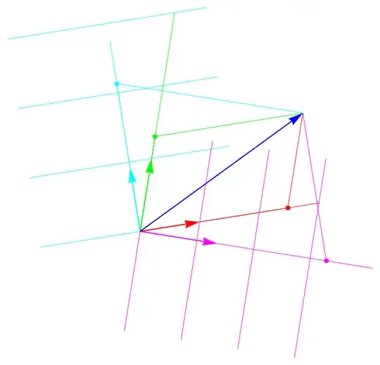

Edit to add graphics.
The first image depicts a vector (blue) resolved onto a covariant basis (red and green), and onto a contravariant basis (cyan and magenta). The basis 1-forms dual to the covariant basis are likewise depicted in cyan and magenta. They are "surfaces" of constant coordinate value. So, if the red line is tangent to the coordinate inducing the red basis vector, the cyan lines are tangent to the subsequent coordinate curves "parallel" to the red line, etc. Notice that the dual (contravariant) basis vectors are orthogonal to their corresponding covariant basis vectors. Also observe that the contravariant basis vectors are orthogonal to their corresponding 1-form surfaces. The same geometric object was used to draw both the 1-forms and the contravariant basis vectors. They were just passed to different functions.

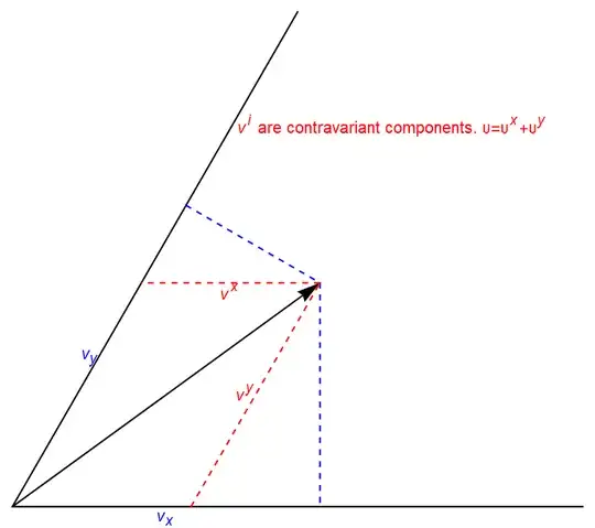

The second image depicts a vector "resolved" onto the covariant basis in terms of both covariant and contravariant components. This requires some scaling which is described in Theoretical Physics, By: Georg Joos, Ira M. Freeman
oblique coordinates

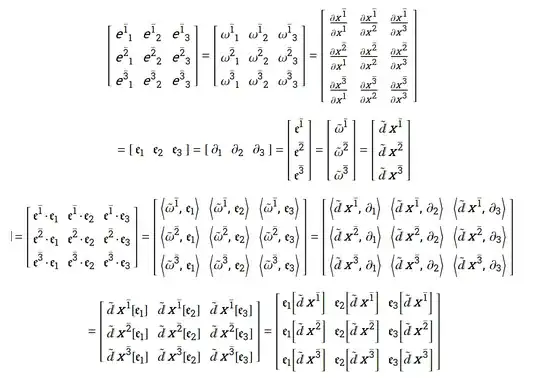

Edit to add: The following image shows equivalent forms of a the component matrix associated with a change of coordinate induced bases. It is by no means exhaustive. It would be too much effort to translate it from Mathematica to LaTeX where I produced it. Of course, one needs context in order to expand the single row and single column forms to show their equivalence with the other forms.
equivalent matrices
