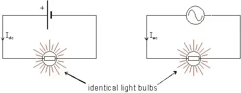

Bulbs
Consider that both the bulbs are giving out equal-level of brightness. So, They're losing the same amount of heat (regardless the fact of AC or DC). In order to relate both, we have nothing to use better than the RMS value. The direct voltage for the bulb is 115 V while the alternating voltage is 170 V. Both give the same power output. Hence, $V_{rms}=V_{dc}=\frac{V_{ac}}{\sqrt{2}}=115 V$ (But Guys, Actual RMS is 120 V). As I can't find a good image, I used the same approximating 120 to 115 V.
