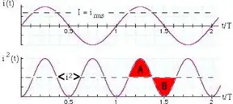

Average power $\left <\rm power \right > = \dfrac{\left <\rm \rm voltage^2 \right >}{R} = \left <\rm \rm current^2 \right > R$ so it is the mean of the values squared which you need to use.
In the example above you will see that the areas $A$ and $B$ above and below the $\left <\rm \rm i^2 \right > = \left <\rm \rm current^2 \right >$ line are equal so the extra energy delivered during the time period of $A$ is exactly compensated for by the reduced amount of energy delivered during the time period of $B$. (Think of it as levelling some ground which originally had a lot of bumps on it.)
Thus a steady current of magnitude $\rm i_{dc} = i_{\rm rms} = \sqrt{\left <\rm \rm current^2 \right >} $ will, over a cycle, dissipate the same amount of electrical energy as the alternating current does over a cycle.
If you wanted the mean of the power squared then you would raise the quantities to the power of four but note that in general $\left <\rm power^2 \right >\ne \left <\rm power \right >^2$.
