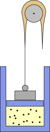

I don't know where such a process is relevant, but you can make up a mechanical apparatus that realizes it, at least in theory. Maybe something like this:
cylinder with piston and a weight on top, a rope that gets thinner towards its ends is attached to the weight
The weight puts some pressure on the piston, but a heavy rope is attached to it, which is thicker in the middle. The rope runs over a pulley and if the piston goes up part of its weight pulls the piston up and reduces pressure. With the right mass distribution you should get $p \propto V^{-n}$.
However, the negative heat capacity would mean that the system is unstable. If it comes in contact with a hotter reservoir, it absorbs heat, whereupon it expands and cools down so it can absorb even more heat and continue expanding. On the other hand, if the reservoir is cooler, it will continue to contract. I can imagine that, in other systems, this may ultimately lead to states which can be described by negative temperatures, but with an ideal gas this is not possible. Ideal gases can only have positive temperatures. Instead, the above contraption would eventually reach its limits, like the end of the piston or the end of the rope, where the pressure no longer follows a polytropic process.
