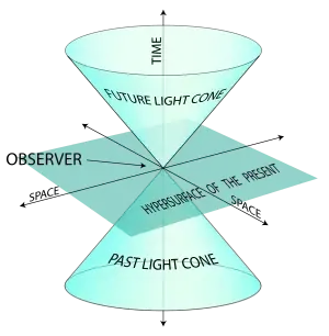

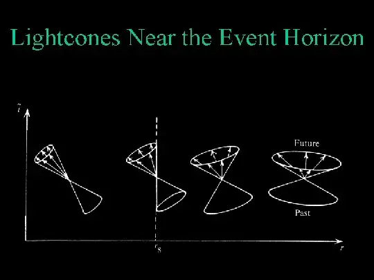

In relativity, we talk about gravity using light cones. If you draw a graph with space on $x$ axis and time on $y$ axis, the speed of light can be visualized as a cone, this is called a light cone, because it represents the trajectory of light. The cone that runs to positive numbers is called a future light cone, the cone that runs from negative numbers is called a past light cone(see figure).
Gravity has a property that it rotates this light cone, it bends the light. The event horizon is a place, where the future light cone is paralell to it, meaning that all light that is emitted there either stays inside the event horizon and will orbit the black hole forever, or falls inside. Below the event horizon all of the future light cones point to the center of the black hole.
enter image description here Inside the black hole, you can literally not see anything below you, you can see only things above. Also, had you somehow managed to fall into a black hole and not get spaghettified to death by its gravity outside the event horizon(which can be achieved given a sufficiently big black hole), you would be killed by the radiation orbitting the black hole on the event horizon that particles that fell into it before you left there.
