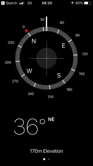

If you have tried to detect the magnetic field to to a mains current directly then you have to realise that you are competing with other (stronger) static magnetic fields which are present including the Earth's magnetic field.
This is a typical display and placing the main cable close to the phone may well not change the net magnetic field direction by a noticeable amount.

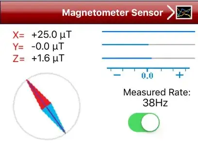

The opening display might look like this noting that I have eliminated the displays for the other sensors which are contained within a smartphone.
This display shows one of the problems with the detection of the fluctuating mains magnetic field at $50\,\rm Hz$ - the sample rate of $38 \,\rm Hz$.
However the x,y and z-components of the magnetic field are displayed to a reasonable sensitivity.

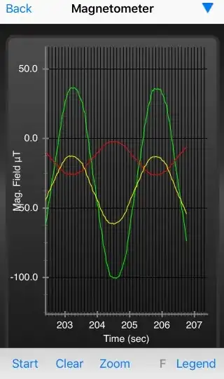

Although you can use this screen activating the time varing screen (top right hand icon) will produce a screen with the magnetic field as a function of time.

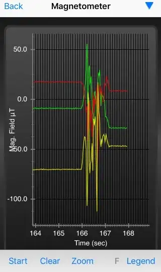

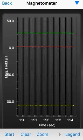

The act of putting a mains cable which is carrying no current will disturb the magnetometer reading before settling down.
Switching on the current (to an electric kettle) shows the effect you were looking for.
The variation of magnetic field is not shown a being at $50 \,\rm Hz$ because the sample rate is not great enough.

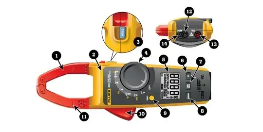

Yes. Indeed, if that were not the case, the millions of clamp ammeters (like these) sold would be useless.
then why the magnetic sensor of my mobile device doesn't react in any way to change
Notice the construction of the clamp ammeter and, in particular, the fact that jaws must enclose just one of the current carrying wires.
