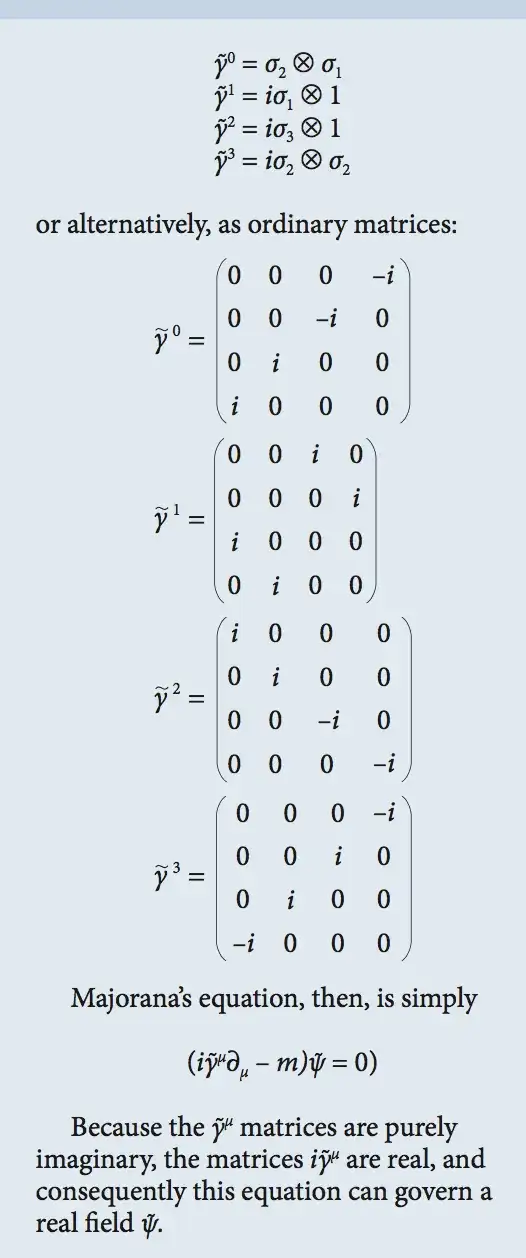

It is known that there is a set of gamma matrices that can be purely imaginary (called Majorana basis), thus one can solve the 1st quantized Majorana wave function in terms of real wave function.
However, I am confused by the implications for this real Majorana wave function.

To see this explicitly, go to the rest frame, as you may always Lorentz-transform yourself back. So, the Dirac equation reduces to just $$ (i\tilde \gamma ^0 \partial_t - m)\psi =0, $$ hence $$ (\partial_t +im\tilde \gamma^0)\psi=0 . $$ Note in this representation $i\tilde \gamma ^0$ is real and antisymmetric, and thus antihermitean, as it should be!
Since it does not mix up the real and imaginary parts of the Dirac spinor $\psi$, we may consistently take the imaginary part to vanish, so the spinor is real: A Majorana spinor in this, Majorana, representation. (In the somewhat off-mainstream basis you display, you may take $C=-i\tilde \gamma^0=-C^T=-C^\dagger=-C^{-1} $.)
The evident solution, then, is $$ \psi (t) = \exp (-itm\tilde \gamma ^0 ) ~~\psi(0)=\exp (-itm ~\tilde \sigma_2\otimes\sigma_1 ) ~~\psi(0)~~, $$ where, as seen, the exponential is real, so the time-evolved spinor is real, as well, forever and ever. Thus, $$ \psi (t) = (\cos (tm)-i\tilde \gamma^0 \sin (tm) ) ~\psi(0) . $$
