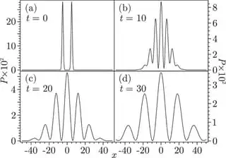

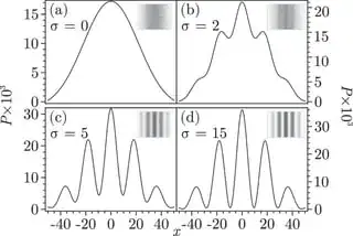

As clearly described in this paper, when particles (like unbounded electrons) are sent individually through a pair of slits, a wave-like interference pattern develops, but no such interference is found when one observes which “path” the particles take.
Observing the particles for which way they went through constitutes a measurement and quantum coherence is lost through decoherence. In the mentioned paper, a measurement precision term $\sigma$ is introduced to quantify the extent of measurement. For example, $\sigma \rightarrow \infty$ implies a measurement with no precision, while $\sigma \rightarrow 0$ corresponds to a measurement tending to perfect precision. For small values of $\sigma$, the interference effects are suppressed.
$\hskip2in$image1
Interference effects at different times when the particles are left unobserved i.e., no measurement or $\sigma \rightarrow \infty$
$\hskip2in$ image2
These figures show the effect of $\sigma$ at a fixed time (here $t=30s$). $\sigma = 0$ indicates a perfect measurement, coherence is lost and only a broad fringe appears. As $\sigma$ increases one can see the interference being restored. Insets show simulated detection screens.
Hence, there exists a clear link between the measurement(our ability to distinguish the path taken by a particle) and the visibility of the interference fringes.
