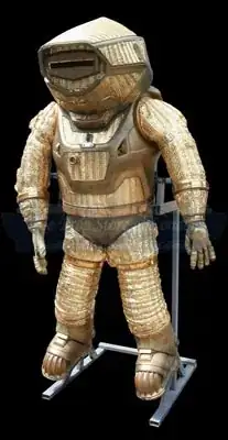

I was wondering if the next step could be jumping from the international space station. The person would have to overcome the orbital velocity of the station, re-enter the Earth's atmosphere, and land on the Earth with their feet, assisted by a parachute.
Would such a stunt be survivable by a human?
Could the person wear a space suit like the one depicted in the movie "Sunshine"? Is such a space suit possible?
