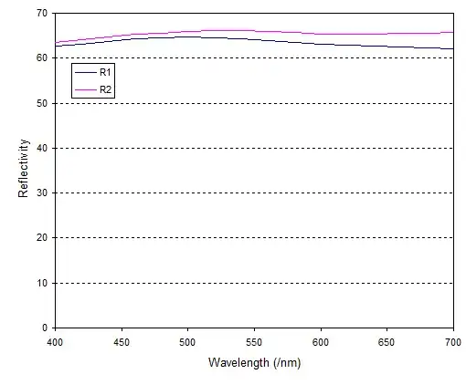

I found reflection spectra of osmium here, and I've graphed them so you can see what they look like:
Full scale
(the article doesn't make clear what $R_1$ and $R_2$ - they are presumably reflection coefficients of some form)

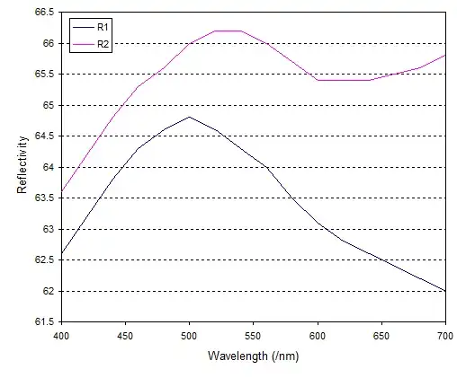

Basically osmium isn't coloured. Compared to gold and copper the spectrum is boringly flat. It's only if we zoom in on the $y$ axis that we can see what's causing the colour:
Zoom in
This shows the reflectivity has a peak for green light (500 - 550nm) and the reflectivity actually falls for blue light (the left side of the graph). The $R_2$ reflectivity holds up at the red end (the right side of the graph) though $R_1$ falls and presumably it's the reduced reflectivity at the red end that causes the blue tint (it would help if the article explained exactly what $R_1$ and $R_2$ are). However this is a very small effect. I suspect it's only the sensitivity of human colour perception that makes the blue tint detectable at all.
Ultimately this is a glorified "I don't know" as you suggested in your question. My point is that there aren't really any absorption features as you get with gold and copper so the slight tint is unlikely to be attributable to a specific electronic feature.
A footnote:
According to this page on the site I linked above the reflectivities $R_1$ and $R_2$ are used for pleochroic minerals i.e. minerals where the reflectivity of plane polarised light depends on the orientation of the light relative to the mineral. Given the difference between $R_1$ and $R_2$ for red light that suggests the blue tint would be orientation dependent if osmium is viewed in polarised light.
