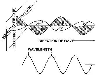

Here are some depictions of electromagnetic wave, similar to the depictions in other places:
enter image description here enter image description here enter image description here
Isn't there an error? It is logical to presume that the electric field should have maximum when magnetic field is at zero and vise versa, so that there is no moment when the both vectors are zero at the same time. Otherwise one comes to a conclusion that the total energy of the system becomes zero, then grows to maximum, then becomes zero again which contradicts the conservation law.

The depictions you're seeing are correct, the electric and magnetic fields both reach their amplitudes and zeroes in the same locations. Rafael's answer and certain comments on it are completely correct; energy conservation does not require that the energy density be the same at every point on the electromagnetic wave. The points where there is no field do not carry any energy. But there is never a time when the fields go to zero everywhere. In fact, the wave always maintains the same shape of peaks and valleys (for an ideal single-frequency wave in a perfect classical vacuum), so the same amount of energy is always there. It just moves.

There is no contradiction with conservation law, you are just applying it wrongly. To do it right, you have to consider a small closed region and check whether the variation of energy inside this domain is the same as (minus) the energy flux through its boundaries. In the case of a electromagnetic wave, when the energy density decreases inside the region, it just means that the energy has left the region you are considering.
