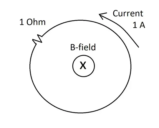

Let's look at a simple example and see why this gets troublesome. Imagine a loop of perfectly conducting wire with a 1 Ohm resistor, with an ever increasing magnetic field perpendicular to the loop. a loop with a resistor, and a perpendicular magnetic field The increase in magnetic field will generate a counter clockwise current, let's say 1 A. The current direction is well defined.
But where is the high potential in the loop? Using electronics formulas we know and love, we would say that there is a voltage drop V = IR of 1 Volt over the resistor. Assume we are at 10 volts on the right, we would be at 9 Volts after the resistor. But wait a minute! If you go back to the right side, there is no drop since there is no resistor. So the voltage must be 9 on the right. Go across the resistor again, you get a voltage drop of 1 Volt, so it must now be 8 Volts on the left of the resistor, and so on. Clearly, this does not work.
This simple example shows that the generated EMF does not work as a simple circuit with a high and low voltage point. Rather, the EMF that drives the current is generated locally throughout the circuit.
So we can't easily define the direction of the EMF, since there is not a point of high voltage and a point of low voltage. What we do for the direction of the EMF, is we look at the current, and we say that the direction of the EMF is such that it generates a current in that direction.
