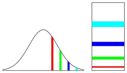

This is my method of deriving the one-dimensional velocity distribution formula. It seems to make clearer the connection between gravitational potential energy and the velocity distribution.
If I accept the hand-waving that allows me to treat the molecules as if they are not interacting, and only consider the relationship between upward speed at height $0$ and potential energy at height $h$, then there is an obvious correlation between upward speed distribution and particle density at the corresponding height.
The attached graphic shows how an interval of the velocity distribution maps onto a depiction of the gas in a column. Each point $v$ in the velocity range corresponds to the height at which $\frac{1}{2}mv^{2}=mgh$. In the velocity distribution diagram, the colored regions are of equal width. In the depiction of the column of gas, they are of different widths because $h=\frac{v^{2}}{2g}$.
Ideal gas in thermal equilibrium is confined to a tall cylinder. Assign some arbitrary horizontal plane height $h_{0}=0$. The equation giving density as a function of height is already established: $$n_{h}=n_{0}e^{-h\frac{mg}{kT}}$$
The only component of velocity under discussion is the positive vertical component, denoted $v$. Height is related to velocity by $mgh=\frac{1}{2}mv^{2}$, or
$$h=\frac{v^{2}}{2g}.$$
So
$$n_{h}=n_{v}=n_{0}e^{-v^{2}\frac{m}{2kT}}$$
Assume there is some velocity distribution $\mathscr{P[v]}$ The proportion of atoms with velocity between $v$ and $v+\Delta{v}$ is given by $$\mathscr{P}\left[v,v+\Delta v\right]=\int_{v}^{v+\Delta V}\mathscr{P}\left[v\right]dv.$$
The atoms in that range will come to rest between the heights $h_{v}=\frac{v^{2}}{2g}$ and $h_{v+\Delta v}=\frac{\left(v+\Delta v\right)^{2}}{2g}$. The number of those atoms is equal to the difference in density between those heights.
So the rate at which atoms with velocities between $v$ and $v+\Delta{v}$ pass $h_{0}$ is the rate at which atoms come to rest between $h_{v}$ and $h_{v+\Delta{v}},$ which, assuming $\Delta{v}$ is infinitesimal is $dn_{h}=dn_{v}$. The rate at which such atoms pass $h_{0}$ is proportional to the number density $n_{0}$, the velocity $v$ and the proportion given by $\mathscr{P}\left[v\right]dv$.
$$v\alpha n_{0}\mathscr{P}\left[v\right]dv=dn_{v}=-v\frac{m}{kT}n_{0}e^{-v^{2}\frac{m}{2kT}}dv$$
Canceling out common factors gives:
$$\mathscr{P}\left[v\right]dv=-\frac{m}{\alpha kT}e^{-v^{2}\frac{m}{2kT}}dv$$
The value of $\alpha$ is given by integrating both sides and setting the result equal to unity. The expression obtained using Feynman's development is
$$\mathscr{P}\left[v\right]dv=-\sqrt{\frac{m}{2\pi kT}}e^{-v^{2}\frac{m}{2kT}}dv.$$
Comparing these results gives:
$$\sqrt{\frac{m}{2\pi kT}}=\frac{m}{\alpha kT}.$$
Solving for $\alpha$ gives
$$\alpha = \sqrt{\frac{2\pi m}{kT}}$$.
I did not explicitly assume the velocity distribution is homogeneous in establishing the distribution formula. But the fact that the derivation gives the same result regardless of the arbitrary choice of $h_{0}$ shows the distribution to homogeneous.
So the question remains. Is the assumption that the atoms can be treated as non-interacting for purposes of this derivation implicitly assuming the velocity distribution to be homogeneous?
