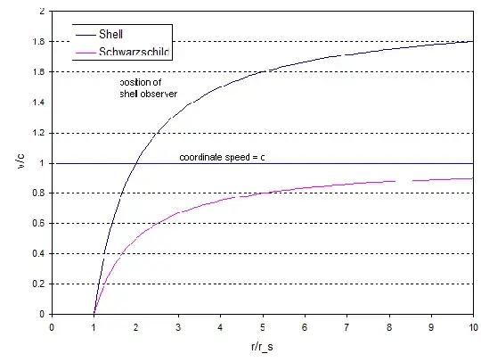

But we can do better than this. We can extend our analysis to find the speed of light in the shell coordinates at radial distances greater and less than the shell distance. The argument is essentially the same as above so I’ll just give the result:
$$ \frac{dr’}{dt’} = \pm c \frac{1- r_s/r}{1 – r_s/R} \tag{4} $$
And this looks like (for $R = 2r_s$):
Coordinate speed of light
Like the Schwarzschild observer the shell observer sees the coordinate speed of light fall when the light is closer to the massive object than they are, but the shell observer sees the light move faster than $c$ when the light is farther from the object than they are. So the shell and Schwarzschild observer agree on the speed of the light nowhere (except at the event horizon if one exists) but they both agree that the speed of light at their location is $c$.
And this makes the point. Shell observers are not some theoretical fiction - you and I are shell observers by virtue of our constant distance from the centre of the Earth and equation (4) gives the speed of light that you and I would observe. The point is that the coordinate speed of light depends on the observer and has no absolute meaning.
