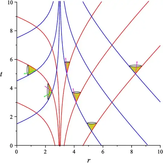

In addition to gj255 answer here is a visual aid, a light-cone diagram in Schwarzschild coordinates:modified image from arXiv:1401.1797
Schwarzschild coordinates here are convenient because timelike at infinity Killing vector field is especially simple here: $\partial_t$, so in the diagram it is a simple vertical translation.
So the contraction $E=p^\mu K_\mu$ in Schwarzschild coordinates is a t-component of 4-momentum (vertical component in the image). Since 4-momentum must lie within the future light-cone at a given point, outside the horizon only positive energies are possible (purple vectors in the image).
Inside the horizon, however, we may also have negative energies (as well as positive), since light-cones are now pointing sideways. So in image we have green vectors, representing negative energies.
