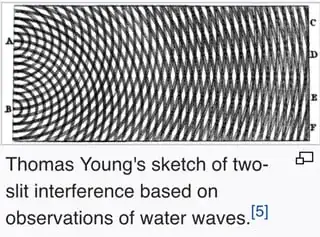

There is another point one can state. Th intensity distribution is a stationary pattern on the screen. That is an astonishing fact because Young derived the wave characteristics of light from the interference pattern of two water waves:
This sketch shows one moment of the “living” pattern. In reality the points C and D are moving to the top and the points E and F are moving downwards. This behavior is not observed for the intensity pattern from light.
