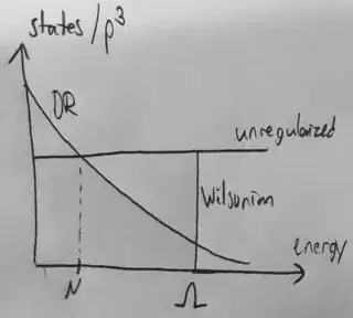

Consider some loop integral in an unregularized theory, $$I = \int d^4 p\, (\text{stuff}) \sim \int_0^\infty p^3\, dp \, (\text{stuff)}.$$ In the Wilsonian picture, the integral would be finite by a hard cutoff, $$I \sim \int_0^\Lambda p^3\, dp \, (\text{stuff)}.$$ In dimensional regularization, we instead work in arbitrary dimension, giving $$I \sim \int_0^\infty p^{d-1} dp \,(\text{stuff}).$$ Then if we take $d < 4$, there are more degrees of freedom with lower energies, and less degrees of freedom with higher energies. If we say we have equality at energy $\mu$ (and this must be true, by dimensional analysis), then dimensional regularization is just doing a smoother version of the hard Wilsonian cutoff, with $\mu \sim \Lambda$!
To clarify, here's a sketch of how the number of degree of freedom at some energy changes in each of these schemes.

To your narrower question: Yes, you can think of dimensional regularization as a softer version of a momentum cutoff. (I like this perspective because it's not necessary to think of dimensional regularization as actually interpolating between spaces of different dimensions. You can get away with this in limited circumstances, but in general, it's just confusing. Spinor representations, for example, don't really adapt well to fractional dimensions.)
The main point of dimensional regularization is that you can examine the singularities of momentum integrals by replacing the usual momentum measure $d^np$ with $\big(\frac{\mu}{|p|}\big)^{\epsilon} d^np$. This is still a measure on the functions on $\mathbb{R}^n$, but the extra powers of $|p|$ in the denominator suppress the high momentum modes in comparison with the low momentum modes. Then you impose renormalization conditions, and remove the cutoff by sending $\epsilon \to 0$.
Note: This isn't quite the textbook definition of dimensional regularization because I haven't bothered to analytically continue the angular measure. For example, in the 'textbook' dimensional regularization, one finds $$\int \frac{d^{4-\epsilon}k}{(2\pi)^4} \frac{1}{(k^2 + \Delta)^2} = \frac{1}{(4\pi)^2} \big(\frac{2}{\epsilon} - \log(\Delta) + \gamma + \log(4\pi) + O(\epsilon)\big).$$ In the variant I'm using here, $$\int \frac{d^4k}{(2\pi)^4} \frac{(\mu/|k|)^{\epsilon}}{(k^2 + \Delta)^2} = \frac{1}{(4\pi)^2} \big(\frac{2}{\epsilon} + \log(\frac{\mu^2}{\Delta}) + O(\epsilon)\big).$$
I don't think this makes any meaningful difference. The angular measure's $\epsilon$-dependence creates some terms constant in $\epsilon$, but it doesn't change the dependence of the integral on external momenta. But as you can see, it does change the expressions that appear at intermediate stages, before you impose renormalization conditions.
