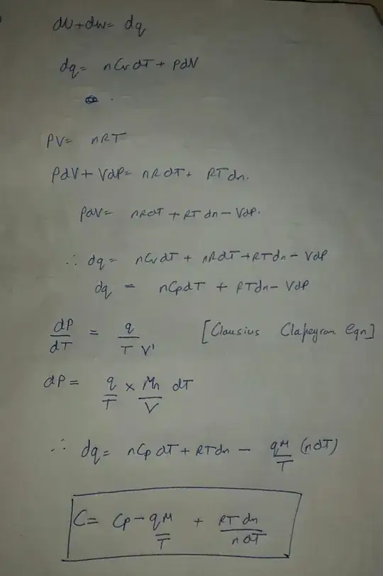

My attempt is shown in the figure that follows
I am mainly concerned with two points in this- 1. I think that the number of moles of gas in the container will not remain constant. So the dn term in my solution cannot be put to zero. 2. Does the solution take in account the heat given to water to turn it into vapour?
If there is any better solution than this please let me know. Thank you enter image description here
$$dq=du+Pdv=dh-vdP=C_PdT-\frac{RT}{P}dP$$ Clausius Clapeyron: $$\frac{dP}{P}=\frac{\Delta H_v}{RT^2}dT$$where $\Delta H_v$ is the molar heat of vaporization at temperature T. So, combining these equations, we have: $$dq=\left(C_p-\frac{\Delta H_v}{T}\right)dT$$
