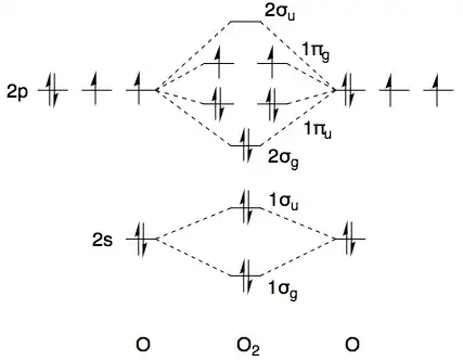

Using dioxygen as an example ($D_{\infty\mathrm h}$ point group, character table here) and ignoring the core 1s-electrons, the ground state has the electronic configuration $(1\sigma_\mathrm g)^2(1\sigma_\mathrm u)^2(2\sigma_\mathrm g)^2(1\pi_\mathrm u)^4(1\pi_\mathrm g)^2$. A quick sketch of the MO diagram is provided below.
MO diagram of dioxygen
The first ten electrons are all paired up and collectively transform as the totally symmetric irreducible representation, i.e. $\Sigma_\mathrm g^+$, so from a symmetry point of view we only need to consider the top two electrons. Both electrons are in a $\pi_\mathrm g$ orbital, and collectively these transform as the direct product of $\Pi_\mathrm g$ with itself. (Irreducible representations are labelled with capital Greek letters, whereas small letters are used for MO symmetry labels.)
$$\Pi_\mathrm g \times \Pi_\mathrm g = \Sigma_\mathrm g^+ + [\Sigma_\mathrm g^-] + \Delta_\mathrm g$$
This means that a $(\pi_\mathrm g)^2$ configuration can have an overall symmetry of either of these three, depending on how the electrons are configured. Now, the square brackets come into play: these represent antisymmetrised direct products, i.e. spatial wavefunctions which are antisymmetric upon permutation of the two $\pi_\mathrm g$ electrons. In order to satisfy the Pauli exclusion principle, this must be paired with the symmetric spin wavefunction, i.e. a triplet spin function. Likewise, the symmetric spatial wavefunctions $\Sigma_\mathrm g^+$ and $\Delta_\mathrm g$ must be paired with the antisymmetric singlet spin function.
All in all, for the ground state electronic configuration of dioxygen $(1\sigma_\mathrm g)^2(1\sigma_\mathrm u)^2(2\sigma_\mathrm g)^2(1\pi_\mathrm u)^4(1\pi_\mathrm g)^2$, we have the permissible term symbols $^1\Sigma_\mathrm g^+$, $^3\Sigma_\mathrm g^-$, and $^1\Delta_\mathrm g$. Obviously, this does not contain the desired $^1\Sigma_\mathrm g^-$, and that is why it does not appear as one of the lower-energy terms in the NIST webbook. There's a good chance you know all of this already, but I thought it helpful to set the scene (and maybe future readers do not know it, so it can't hurt).
