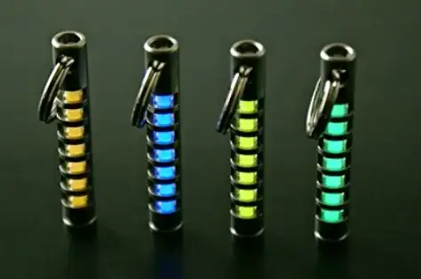

I recently purchased a tritium keychain, composed of a small glass vial of tritium gas partially enclosed in a stainless steel fob. Here are the Amazon links so you can see a specific example:
The glass vial is 12mm long and 2mm diameter. Here's a picture of what they look like for future-proofing against link rot:
Tritium vial keychains

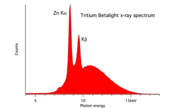

The beta electrons have a maximum energy of 18.6 keV and all of them are absorbed by the glass or plastic. But there is some Bremsstrahlung x-ray intensity. I measured the spectrum in 2015 with an Amptek silicon energy-dispersive detector, see below. The intensity was low - it took several days to collect these data. The maximum of the continuum is consistent with the maximum beta energy. There are also characteristic peaks of zinc $K_\alpha$. I attribute those to x-ray fluorescence from a zinc-oxide phosphor.
The spectrum is similar in energy to what one would receive from old-fashioned cathode-ray tv-screens with a similar energy of the electron beam. But the visible light from these key chains is many orders of magnitude weaker than that of a CRT screen. The "current" of beta electrons is only $3.7\cdot10^5 \times 1.6 \cdot 10^{-19} = 0.06$ picoampere, which is much less than the typical electron beam current of a CRT display, about a milliampere. (But CRT screens often have heavy (lead etc) glass on the front.)
