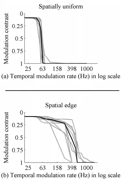

Human vision is a complex system and not everything is understood about it yet. However, capabilities of our vision are well studied and the actual answer to the question is that they are not good enough to see the light flicker of the light bulb (in most cases). In this study published in Nature, Scientific Reports, 2013, it was found that humans can detect some changes in the displayed picture on a monitor which are spatially uniform with threshold of the modulation of about 63 Hz. And for images with some sharp spatial edges even up to 500 Hz!
I assume it is safe to think of the incandescent bulb as of a ‘spatially uniform’ image. Speculations are that the changes in the light intensity are much smaller compared to the average value and they happen at a rate of ~ 100-120 Hz, which is higher than our capabilities, according to the cited research.
In case of the fluorescent tube, the changes in the light intensity are significantly bigger and one can assume that this case is closer to images with ‘spatial edge’ from the research. Therefore, the detection threshold could be higher. This may be the reason why some people can have headaches with such lighting.
