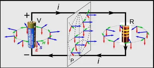

It's pretty fascinating when you think about how electrical energy is actually transferred. Most of us imagine electricity as electrons flowing through wires, but in reality, it's much more complex. Electrical energy isn't directly carried by those electrons—it’s transferred through electric and magnetic fields around the wire. This transfer can be measured using Poynting vector, which we can use to find the direction using right hand rule
more about POYNTING VECTOR
MY DOUBT
In the case of DC, the current flows in one direction, and so does the electric field. Using the right-hand rule, we can easily visualize how energy is transmitted from the battery to the bulb. But when we switch to an AC source, the direction of electron flow constantly changes, and with it, the electric field also oscillates.
This raises an interesting question: if the direction of energy transmission keeps changing in AC, how is the energy actually transmitted to the device? And if the energy is constantly reversing direction, how does the bulb still manage to glow continuously? Without affecting the efficiency of the devices my question is more generalized. Instead of focusing on a specific example like a light bulb, I'd like to concentrate on the broader concept of energy transfer, particularly how alternating current (AC) functions.
NOTE: This is not the duplicate question, read the question properly...the whole reason for this question is to understand the direction of energy transformation (according to the Poynting vector), why does it not change when the electric and magnetic field direction changes
This is correct, but it is incomplete. For a resistive load the current is proportional to the electric field, so the current also oscillates. The oscillating current produces an oscillating magnetic field. So both the electric and the magnetic fields oscillate.
This, however, is not correct. The direction of energy transmission does not change. The Poynting vector is the cross product of the electric and magnetic fields. When you take the negative of the electric field and the negative of the magnetic field, a negative times a negative is a positive. The energy flows in the same direction in both cases.
