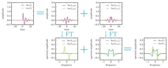

However, I don't think this is the most useful way to see things, and there is a beautiful time-domain argument that's much clearer; it's explained quite well in Wikipedia but it bears repeating here. When seen from a time-domain perspective, the Kramers-Kronig relation are a simple mixture of two key insights:
  • The real and imaginary parts of the Fourier transform $\boldsymbol{ \tilde\chi(\omega)}$ are in one-to-one correspondence with the even and odd parts of the time-domain $\boldsymbol{\chi(\tau)}$ This is a simple bit of standard Fourier lore - if a function is even its Fourier transform is real, and if it's odd its transform is imaginary; for arbitrary functions just add the two.
  • If a function is zero for all times $\boldsymbol{\tau<0}$ then its even and odd parts must be equal at $\boldsymbol{\tau>0}$ and opposite at $\boldsymbol{\tau<0}$. In other words, the only way to have $\chi(\tau)=0$ for all $\tau<0$ is to have the even and odd parts be given by \begin{align} \chi_\mathrm{even}(\tau) & = \frac12 \chi(|\tau|) \\ \chi_\mathrm{odd}(\tau) & = \frac12 \mathrm{sgn}(\tau)\chi(|\tau|), \end{align} or in other words $$ \chi_\mathrm{odd}(\tau) = \mathrm{sgn}(\tau)\chi_\mathrm{even}(\tau) \quad \text{and} \quad \chi_\mathrm{even}(\tau) = \mathrm{sgn}(\tau)\chi_\mathrm{odd}(\tau). $$
The Kramers-Kronig relations are just the Fourier transforms of those two identities, using the convolution theorem to calculate the transforms of those products. This makes those transforms convolutions, $$ \mathcal{F}\left[\chi_\mathrm{odd}\right] = \mathcal{F}\left[\mathrm{sgn}\right] \ast \mathcal{F}\left[\chi_\mathrm{even}\right] \quad \text{and} \quad \mathcal{F}\left[\chi_\mathrm{even}\right] = \mathcal{F}\left[\mathrm{sgn}\right] \ast \mathcal{F}\left[\chi_\mathrm{odd}\right] $$ and if we put in that first insight we get $$ i\operatorname{Im}\mathopen{}\left(\tilde\chi\right) \mathclose{} = \mathcal{F}\left[\mathrm{sgn}\right] \ast \operatorname{Re}\mathopen{}\left(\tilde\chi\right) \mathclose{} \quad \text{and} \quad \operatorname{Re}\mathopen{}\left(\tilde\chi\right) \mathclose{} = \mathcal{F}\left[\mathrm{sgn}\right] \ast i\operatorname{Im}\mathopen{}\left(\tilde\chi\right) \mathclose{}, $$ and if we make those convolutions explicit, we get \begin{align} \operatorname{Im}\mathopen{}\left(\tilde\chi(\omega)\right) \mathclose{} & = -i\int_{-\infty}^\infty \mathcal{F}\left[\mathrm{sgn}\right](\omega-\omega') \, \operatorname{Re}\mathopen{}\left(\tilde\chi(\omega') \right) \mathclose{} \mathrm d\omega' \quad \text{and} \\ \operatorname{Re}\mathopen{}\left(\tilde\chi(\omega)\right) \mathclose{} & = i \int_{-\infty}^\infty \mathcal{F}\left[\mathrm{sgn}\right](\omega-\omega') \, \operatorname{Im}\mathopen{}\left(\tilde\chi(\omega') \right) \mathclose{} \mathrm d\omega' \end{align} (modulo the fact that I'm not caring about the normalization of the transforms and the convolutions).
As far as the core bits of intuition are concerned, this is it, really: these identities are now in the same structural form as the final Kramers-Kronig relations, and the only thing that remains is to calculate the Fourier transform of the sign function: like the Fourier transform of the Heaviside function, is a distribution, and its Fourier transform is nontrivial to calculate, but that's where the Cauchy principal value comes from.
So, finally, let me wrap this up with Wikipedia's graphical summary of the process:
Image source
