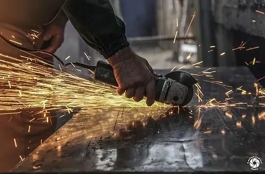

Here's another example :
The swarfs coming out of the grinder are much hotter than your foil (they glow), yet aren't painful to touch because they don't have much mass or energy.
