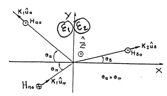

According to Fresnel's equations for the magnetic field parallel to the surface of a dielectric, the reflection coefficient is this: $$r_{s}=\frac{\cos\theta^{i}-\frac{n_2}{n_1}\cos\theta^{t}}{\cos\theta^{i}+\frac{n_2}{n_1}\cos\theta^{t}}\tag{R}$$

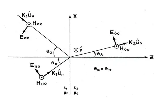

In all the examples I have found, the magnetic field's direction "looks"(I'm not sure what is the correct term) at the reader (like this)enter image description here However, when the magnetic field "looks down", like thisenter image description here
the reflection coefficient I have found is the negative of Fresnel's. $$r_{s}=\frac{-\cos\theta^{i}+\frac{n_2}{n_1}\cos\theta^{t}}{\cos\theta^{i}+\frac{n_2}{n_1}\cos\theta^{t}}\tag{R}$$ Is this correct or are my calculations wrong? Here the user concludes that this is caused by a phase shift, is that the case here too?

If you've changed the direction of the incoming magnetic field $\vec{H}_{\pi 0}$ but kept $\hat{u}_\pi$ pointing in the same direction, then you must have implicitly changed the direction of the incoming electric field $\vec{E}_{\pi0}$ (since $\vec{E} \times \vec{H} \propto \vec{k}$.) Since the Fresnel coefficient is defined as the ratio of $\vec{E}_{\alpha0}$ to $\vec{E}_{\pi0}$, it makes sense that flipping the sign of the magnetic (and electric) field flips the sign of the Fresnel coefficient; it's merely a matter of the definitions you choose.
