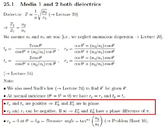

Now this is where my main question begins: According to every source I encounter they typically state "the reason for the minus sign is because there is a phase difference of $\pi$ between the reflected wave and the incident wave."
Walter Lewin used the same calculation as in $(\mathrm{N})$ and reached the box I marked blue and asked his audience "What is the meaning of the minus?" Which can be seen at $53$ min in his Lecture "8.03 - Lect 18 - Index of Refraction, Reflection, Fresnel Equations, Brewster Angle". One of his students answered that the meaning of the minus is $180^{\circ}$ phase difference. Then Walter goes on to give further reinforcement that the minus means $\pi$ phase difference and gave an intuitive (heuristic) reasoning for this (which sadly does not answer my question here).
Here is a short extract from my lecture notes:
Lecture notes
The text I enclosed in red for those two bullet points requires justification. Why does 'positive' imply 'in-phase' and 'negative' imply 'phase difference of $\pi$'?

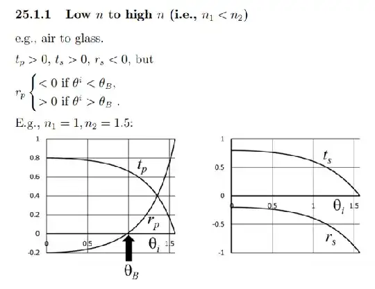

Finally, I would like to understand why the sign change occurs in the curve of $r_p$; as it is the only reflection to incident ratio that actually crosses the $\theta_i$ axis:
Lecture notes second page
Looking at the graph on the left I am told that the phase difference
$$\theta^r-\theta^i=\begin{cases} \pi & \text{if}\quad \theta^i \lt \theta_B \\ 0 & \text{if}\quad \theta^i \gt \theta_B \end{cases} $$
without proof. I am getting very tired of being told this without explanation. On page 391 of "Introduction to Electrodynamics" 3rd edition by "David J. Griffiths" is the same graph as that on the left of the image above and his reasoning is that
On the graph, a negative number indicates that the wave is $180^{\circ}$ out of phase with the incident beam.
Which again is useless to me and doesn't explain with any rigour the mathematical reasoning; which is the sort of explanation I am searching for.
