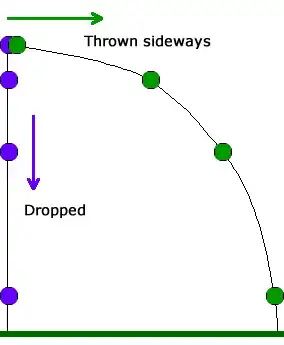

My textbook says that a ball dropped vertically and a ball thrown sideways will not only both land simultaneously but their height will be corresponding for the entire fall, as shown in a diagram which has a ball falling vertically and a ball with an arch landing simultaneously.
This has really struck me as it feels intuitive that the ball dropped vertically would land faster, perhaps due to it traveling a shorter distance.
When I tried to think about it for myself, I came to the thought that perhaps it was due to gravity constantly pulling both of the balls, however would the sideways velocity not slow it downwards speed? For eg wouldn't a bullet take longer to land than a dropped bullet as it is traveling straight?
The image of the sideways ball

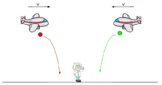

Consider this situation where you have two planes travelling towards each other at some speed $v$, and as they pass each other both drop a ball: (the usual caveats apply: we're neglecting air resistance and any aerodynamic properties of the balls):
Dropped object
Hopefully it should be obvious that both balls will hit the ground at the same time because the situation is symmetric.

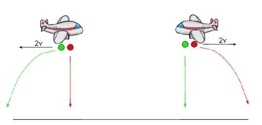

But now consider what the pilot of the plane on the left sees. As far as that pilot is concerned he drops his ball (the red ball) straight down so it falls in a straight line to the ground:
Dropped objects
But from his perspective the ball dropped by the other plane (the green ball) is travelling sideways at a speed $2v$ so it falls in a curve.
And the pilot of the plane on the right sees exactly the opposite. From his perspective he drops his (green) ball straight down while now it's the red ball that is moving sideways at a speed $2v$ and falls in a curve.
But we know that both balls touch the ground at the same time because the physicist watching from the ground sees both falls touch the ground at the same time. And that means the horizontal velocity cannot affect the vertical motion of the balls.
