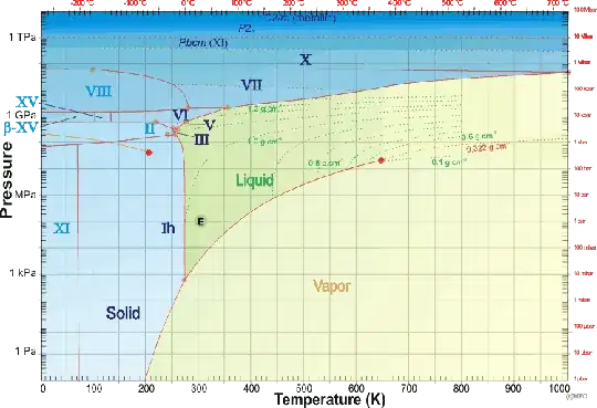

Yes. The Phase Diagram of a substance shows when that substance is in which state. Here is a phase diagram of water (source):
Phase Diagram of Water
You can see that there are phase boundaries between each pair of states. Where all three states meet is the Triple Point. The boundary where solid and gas (vapor) are adjacent is generally below the triple point in both temperature and pressure; for water it starts at the familiar freezing temperature, but at less than 1% of standard atmospheric pressure. If you want to get water to desublimate, you'll have to do it in near-vacuum.

It is possible to go from the solid state to a liquid/vapor state. What I mean by liquid/vapor state is that there is a certain point called the critical point at which liquid and vapor are indistinguishable.
The critical point you are interested in is the end of the liquid-vapor equilibrium curve on which under strictly defined circumstances the phases coexist without any flows. To do that you need to have very high pressure and then heat up the solid as shown in this graph: https://upload.wikimedia.org/wikipedia/commons/thumb/3/34/Phase-diag2.svg/530px-Phase-diag2.svg.png
