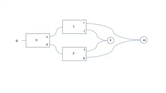

I consider a two-state spin 1/2 system and three devices (0, 1 and 2). Each device splits an incoming stream of particles according to its spin property with respect to a unitary base. Think Stern-Gerlach.
For device 0 the unitary base is (u,d), for device 1 it is (r,l) for device 2 it is (f,b). We may think of up, down; right, left; forward, backward and in 3-space of the z, x and y directions. The devices are wired as in the drawing. Two outputs each of the two devices 1, 2 in the second stage are combined and connected to particle counters k and m. The entire setup is protected against external influences. Measurements are made only in the detectors k and m.
Using the two rules from above, the particle can reach k via two paths (requiring addition of amplitudes) and each of the path consists of two steps (requiring multiplication of amplitudes). That is how I get as amplitudes:
$<k|\psi> = < l | u > < u | \psi > + < f| d> < d | \psi >$
$<m|\psi> = < r | u > < u | \psi > + < b| d> < d | \psi >$

Now my problem: The probabilities do not always add up to 1. As example let us take u=r=f=z+ and d=l=b=z- and as initial state x+. Then we calculate an amplitude of $1/\sqrt{2}$ for arriving at detector m via the path through u and r and the same amplitude for the path via d and b. The amplitudes add up to $\sqrt{2}$ and the probability is 2.

The rules you've talked about above apply only to particles which have no properties besides their position; you need to be more careful when dealing with particles with spin.
If a particle can be spin up or spin down, the probability for it to appear at point $k$ is the sum of the probabilities for a spin up particle to make it and a spin down particle to make it; you add the probabilities, not the amplitudes. This is true even if your detector at point $k$ is blind to spin; in principle we could measure what the spin was.
Feynman anticipated this back in Lecture 1, where the postulate is stated as
If an experiment is performed which is capable of determining whether one or another alternative is actually taken, the probability of the event is the sum of the probabilities for each alternative. The interference is lost.
In your case, the probability for a spin up particle to end up at $k$ is $(1/\sqrt{2})^2 = 1/2$, the probability for a spin down particle to end up at $k$ is also $1/2$, and the total probability is indeed $1$.
Your second question touches on a different issue. For concreteness, let's consider a sharper situation: keep everything aligned along $z$, but right before the spin down particle gets to point $k$, we put it through a magnetic field that swaps spin up and spin down by precession. Then everything that gets to $k$ is spin up, so we can't tell how it got there at all.
The problem here is that the implied time evolution is not unitary: two distinct physical states (a spin up particle on one path, a spin down particle on another) both evolve to the exact same final state. If you run that in reverse, you've broken determinism! Such evolution is forbidden in quantum mechanics. It's not in Feynman's axioms because it's a statement about the dynamics, while his axioms are just for getting predictions out once you know the dynamics.
To see why this can't happen in another way, note that the splitting and refocusing of beams by Stern-Gerlach apparatuses depends crucially on the fact that spin up and spin down particles feel different forces. If you have two beams of spin up particles, you can't merge them; they feel the exact same force. You might think you can do it with some trick, but this rule runs deep; it's even baked into classical mechanics as Liouville's theorem.
Your more general case with partial distinguishability is similar. The more distinguishable you make the paths, the better you can combine the beams. You can probably get a quantitative unitarity bound with some work, but I would imagine it gets kind of complicated; this is why Feynman does his best to avoid talking about it.
