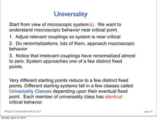

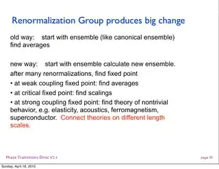

The way it's precisely (though not necessarily rigorously) defined is by considering a field theory description of the statistical system and the renormalization group (a nice intuition of which can be gained from Kadanoff's block scaling).
How the renormalization group applied to a statistical field theory explains the universality classes is nicely summarized in two slides from a Kadanoff's talk:
Kadanoff slide 33 Kadanoff slide 35
Also, from Wikipedia:
The renormalization group [...] classifies operators in a statistical field theory into relevant and irrelevant. Relevant operators are those responsible for perturbations to the free energy, the imaginary time Lagrangian, that will affect the continuum limit, and can be seen at long distances. Irrelevant operators are those that only change the short-distance details. The collection of scale-invariant statistical theories define the universality classes, and the finite-dimensional list of coefficients of relevant operators parametrize the near-critical behavior.
