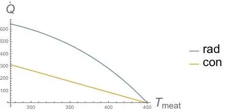

Obviously this is a function of time since the $\Delta T$ will change with time. The constant factors for each are $\sim 1.8 \times 10^{-8}$ W K-4 for $\dot{Q}_{rad}$ and $\sim 1.8$ W K-1 for $\dot{Q}_{con}$. One can go ahead and plot the transfer rates (see figure below) and find that radiative transfer always dominates.
Radiative vs. Conductive Heating Rates

So if we can truly ignore convection, then it appears that radiation dominates over conduction.
