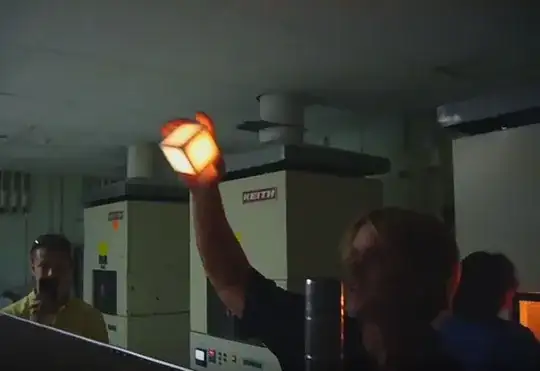

Note that this effect is not exclusive to air, but can be observed with any materials which have low thermal conductivity. For instance, here's a guy holding a glowing-yellow (around 900°C) chunk of aerogel with his bare hand, just out of the furnace:
(taken from this youtube video).
