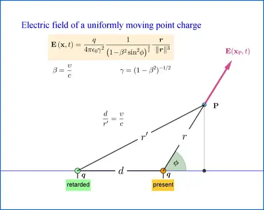

Video here : Electric field of a uniformly moving point charge
