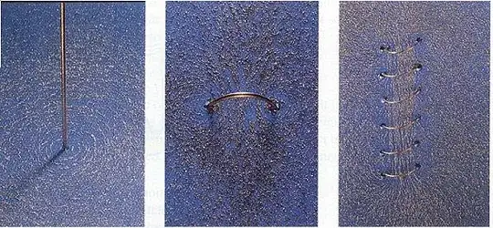

A straight wire does have a magnetic field. It circles around the wire instead of going in a straight line like in a coil.
Magnetic fields of various shaped wires
Picture source: http://coe.kean.edu/~afonarev/physics/magnetism/magnetism-el.htm
On the left is a straight wire with the magnetic field curling around it. The middle shows a single loop of wire. Notice that the magnetic field still curls around the wire, but the fields from opposite ends of the loop add together to make a strong field. The right picture shows a multi-loop wire (a solenoid), which enhances the field compared to the single loop. The right picture is the kind of field you created with the wire and nail. For the same current, the solenoid creates a much stronger field, which is why it is used to magnetize the nail.
To answer your original question, a single electron in motion does have a magnetic field that's similar to the straight wire (the field curls around the electron's path of motion) except that it gets weaker as you move farther away along the electon's path.

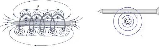

My only guess are the electrons are accelerating; the magnitudes of their speeds aren't changing, but rather their directions.
Wrong guess. Here is the definition of the magnetic field,exactly based on the force induced on a moving test charge
fqvb
Experiments show that the magnetic field of a moving charge can be expressed as:
moving charge
$μ_0$ is called the permeability of free space. The constant $ε_o$ that is used in electric field calculations is called the permittivity of free space. Note that $ε_oμ_o$ = 1/c2.
Just like the charge of the electron is an experimental fact, the magnetic field around a moving charge has been measured by experiment.
You state:
In the coil, a force must be applying itself to the electrons in order for them to make their spiralling paths.
The force comes from the electric fields in the solid state lattice of the coil, with which individual electrons in the current interact.
thus, they are said to be accelerating and that is what causes the magnetic field to develop.
Acceleration of electrons induces radiation, not a magnetic field, whether linear or circular. In a current carrying wire it is not one electron running around in the coil, but many drifting along the lattice of the wire, building up the current in the coil incrementally. The magnetic field of individual electrons is following this incremental steps, according to the formula above and the integration builds the magnetic field of the coil.
